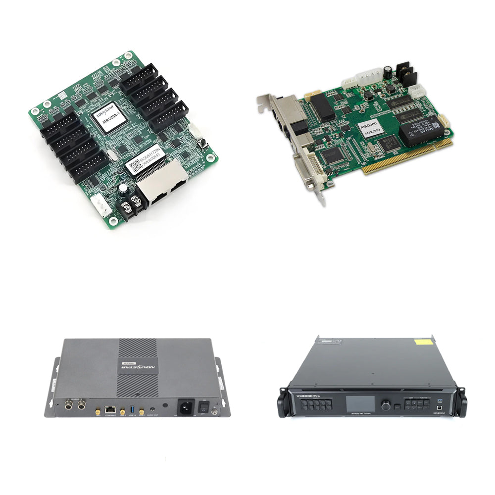

Receiving Card
Role: Installed inside the cabinet, it receives data packets from the sending side, handles mapping, brightness/color calibration, and outputs timing signals to LED modules.
Key Specs: Maximum pixel load (e.g., 256×256), supported HUB interface types and scan modes, dual-port redundancy, monitoring (voltage/temperature).
How to Choose: Make sure each cabinet’s pixel count ≤ card capacity, match HUB interface with module type, and choose redundancy/monitoring features for critical projects.
Typical Use: Essential for everything from small retail screens to large outdoor installations — the “brain” closest to the display.
Sending Card
Role: Installed on the control side (PC or rack), it takes real-time images from the GPU/DVI/HDMI source and packages them into network data to send to the receiving cards.
Key Specs: Input resolution limit, total pixel loading capacity, number of output ports, backup and fiber support.
How to Choose: Total screen pixels must not exceed the sending card’s capacity. For wide or multi-screen setups, consider port count and zoning. Low-latency models are recommended for live events.
Multimedia Player
Role: A standalone controller with built-in storage and operating system. It supports remote program publishing, scheduling, and offline playback.
Advantages: No need to keep a PC running; supports cloud-based management; simple cabling.
Limitations: Limited loading capacity; not suitable for live or real-time playback. Typical Use: Perfect for retail signage, building directory screens, and information displays.
Processor
Role: Handles multiple video inputs, scaling, layout arrangement, signal switching, and often integrates a sending function (all-in-one).
Key Specs: Total loading capacity, number and type of input ports, number of windows, latency, redundancy and fast switching capability.
How to Choose: Multi-source or multi-camera projects require low-latency, multi-window processors; large LED walls need higher loading capacity; mission-critical projects benefit from backup and failover features. Typical Use: Stage rental screens, exhibition setups, control rooms, and monitoring centers.
