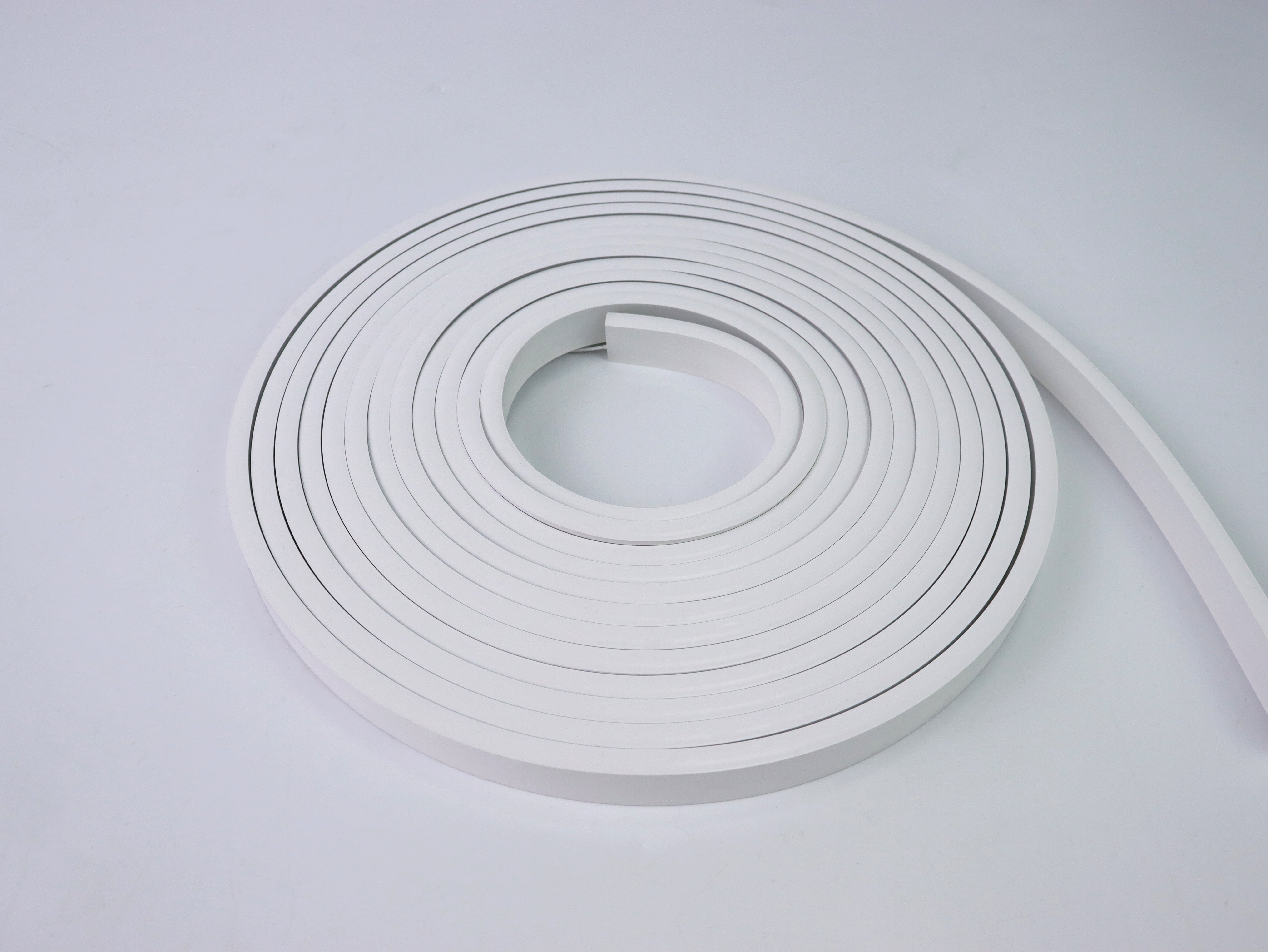

7. Recommended Sleeve Sizes
The sleeve isn’t just a “casing”—it determines light quality and installation ease. Here are some common options:
Side-emitting · 6×12 mm (5 m / 16.4 ft)
 Fits 8 mm wide strips, IP67 waterproof, includes end caps and clips. Great for small home décor.
Side-emitting · 4×10 mm (5 m / 16.4 ft) — S0410
 Slim design for ~5 mm PCB strips, perfect for fine lettering, outlines, or small details. Includes mounting accessories.
Side-emitting · 6×13 mm (5 m / 16.4 ft)
 Slightly wider channel for brighter or larger strips, producing more uniform light. Good for layered designs.
Side-emitting · 5×13 mm (5 m / 16.4 ft) — S0513
 Suits standard 10 mm PCB strips, ideal for bold shapes, wall décor, or signage. Comes with waterproof end caps for outdoor use.
Choose based on design size, strip width, and environment.
