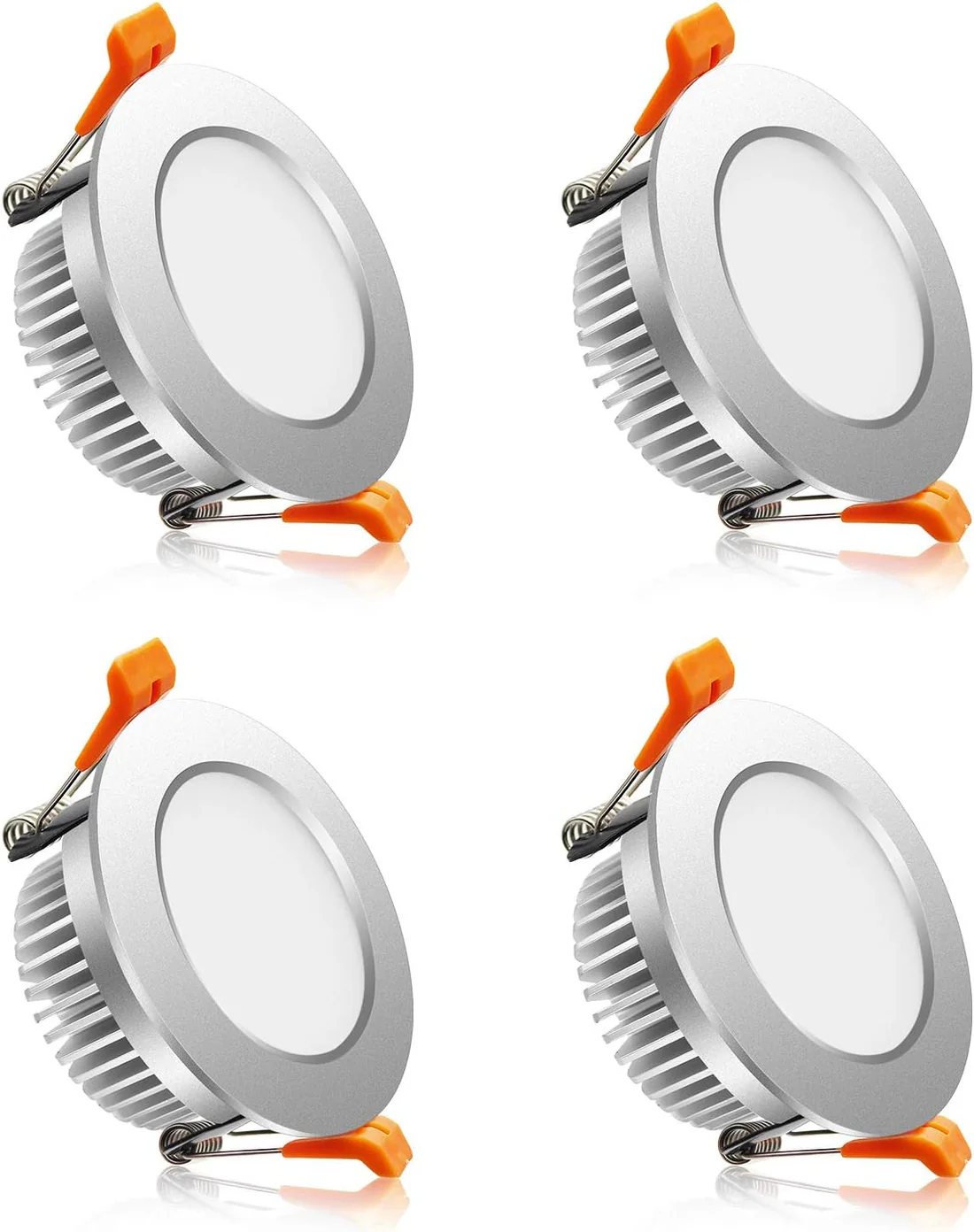

6. Recommended LED Downlight Models
Model
Wattage / Cutout
Key Features
Best Use Case
ECO-1 Series Frosted LED Downlight
3W / 5W / 7W / 9W, 2700K–6000K
Affordable, TRIAC dimmable
Living rooms, bedrooms, hallways
