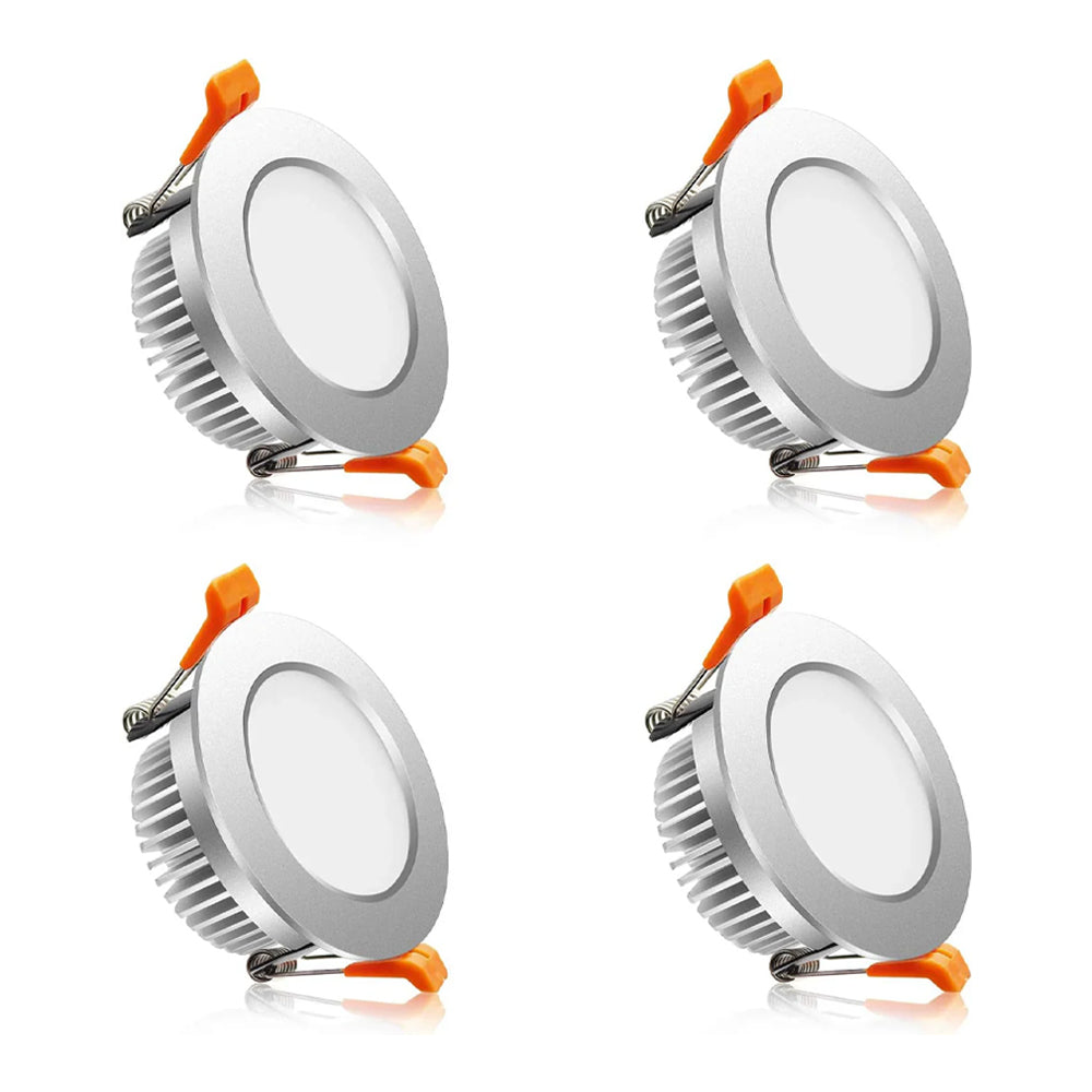

6. Recommended LED Downlight Models
| Model | Wattage / Cutout | Key Features | Best Use Case |
| 3W / 5W / 7W / 9W, 2700K–6000K | Affordable, TRIAC dimmable | Living rooms, bedrooms, hallways | |
