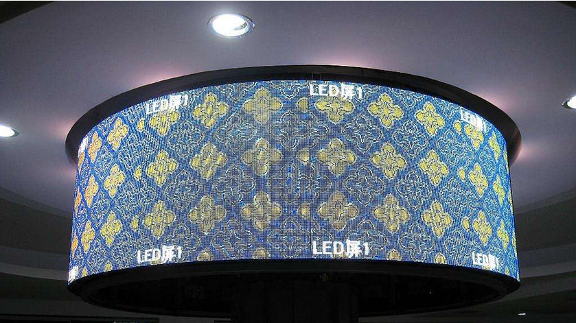

E.g: such a customer need cylinder LED display screen, P2.5 for the module option, perimeter's width - 1 meter, height 2 meters about the cylinder. It's a simple math question here, sums up the size of object surrounding around the cylinder column, that is Area: π(3.1415928) * D(1 meter) * Height(2 meters) =
3.1415928 * 2 (square meters), considering the P2.5 module size 0.32 * 0.16 (square meters),
3.1415/0.32=9.817
2/0.16=12.5
According to the division's output, we could easily get that this customer will need 9.817 * 12.5 pieces of P2.5 module, unfortunately, the module could not be divided smaller than it could be presenting currently, it also will tell the customer that he/she will have some choices or resolution below:
A. Adopting 10 * 13 pieces of P2.5 module, you will get a new cylinder instead of your target, the one is going with perimeter 3.2 meters, diameter 1.018 meters and 2.08 meters in height about this new cylinder.
B. Using 9 * 12 pieces of P2.5 module for plan B, the processing is similar to plan A.
The rest two choices we are not going to list here as we do not recommend, nevertheless, both are available for us to create for you.
